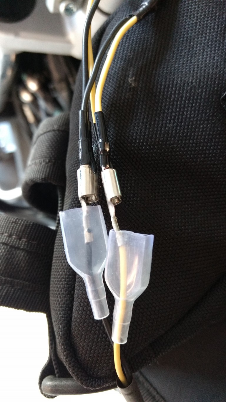

Ah, you misunderstood me.  I also used the connector you show (AMP Superseal for reference - I made up my own plugs though as it saves another connector further along).
The connectors I am talking about are lodged inside the wiring loom you get with the DRL from Barkbusters.  They are hidden underneath the plastic sheathing and they are rather poorly thought out.
The plastic bits slide off and create a short.  Really annoying.

Only issue I have is the indicators they work if you turn them on normally, But if I put my hazards on the indicators trip out and take a few seconds to reset and work again. I'm assuming its something to do with the resistors fitted with the Barkbusters indicators and the indicators drawing too much power, because if I remove a bulb or connect and led indicator instead of the standard one the hazards work fine. So it looks like I may have to convert the front indicators to LED.
