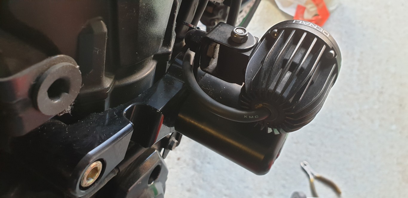

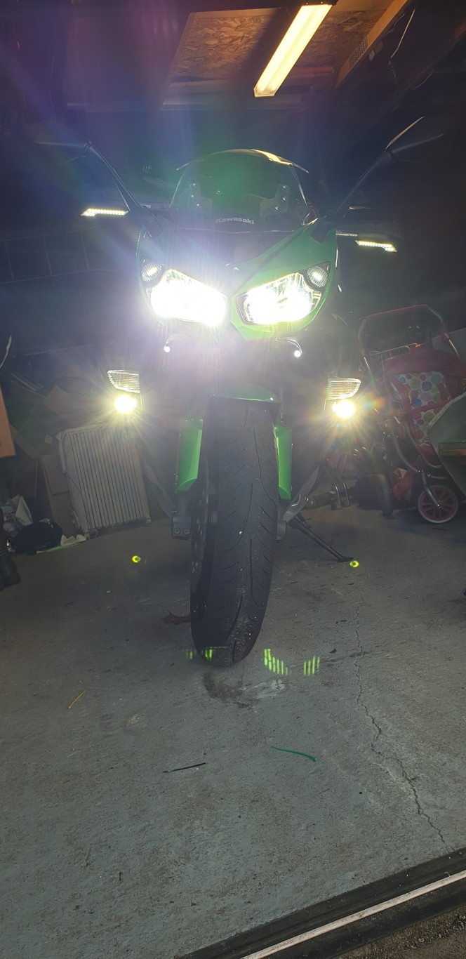

Now had LED in for a while with no issues, although my led don't seem to have the external fan you all seem to have.
Anyway, decided to add my Denali spots too so now have veritable light fest.
In reality all lights are a good colour match (LED in headlight, LED sidelight bulbs, Barkbuster LED handguards, 2x Bikevis bullets plus Denali D2 spots (in 1000% more with high beam, 50% with dipped).   Night ride test to come.
Also just in case there are any questions, yes the indicators do still stand out when lit.
Used a mounting plate on same bolt as r&g bungs
