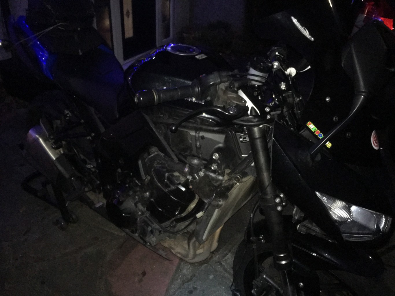

Fairing removed, by moonlight and head torch in the end  :112:
fairly easy just got to have faith and give them a generous tug at some points.
A bit behind where I wanted to be but just means tomorrow I’ve got to wash, ACF50 it all fit rad guard and replace rear hugger  :087: busy new year it’ll be lol
I’m just nervous now, getting it off is the easy part. Just got to remember how it all goes back on!  :187:
Still I need the bike Wednesday morning for work, so it’s got to all be done!  :006:

Seriously mate if you can take em off in the dark I reckon youll be fine putting them back on in the day light  :008:
